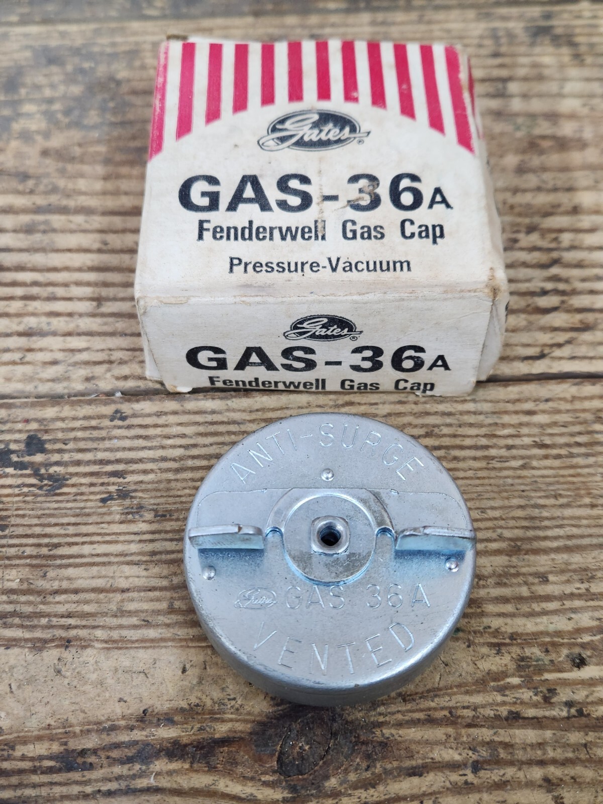

Quality USS fuel tank from 1957...amazingly rust free also inside....
I have never made an autopsy on a vented fuel cap before..easy to drill away the center rivet and put new gasket paper pieces. The rivet was replaced with a 1/4" bolt.
Edited by 22mafeja 2023-01-15 8:00 AM

Ralf: Lucky you with the gas tank. Looks in great shape.
As for the gas cap, did that rivet have a hole in it (in the middle) by chance?
IF so, that was the vent hole and your bolt isn't allowing air into the tank as the fuel is consumed by the engine = vacuum in the tank, tank implodes (slowly) and/or your engine get starved of fuel because of fuel pump can't suck against a vacuum.
I hope that I am wrong.
