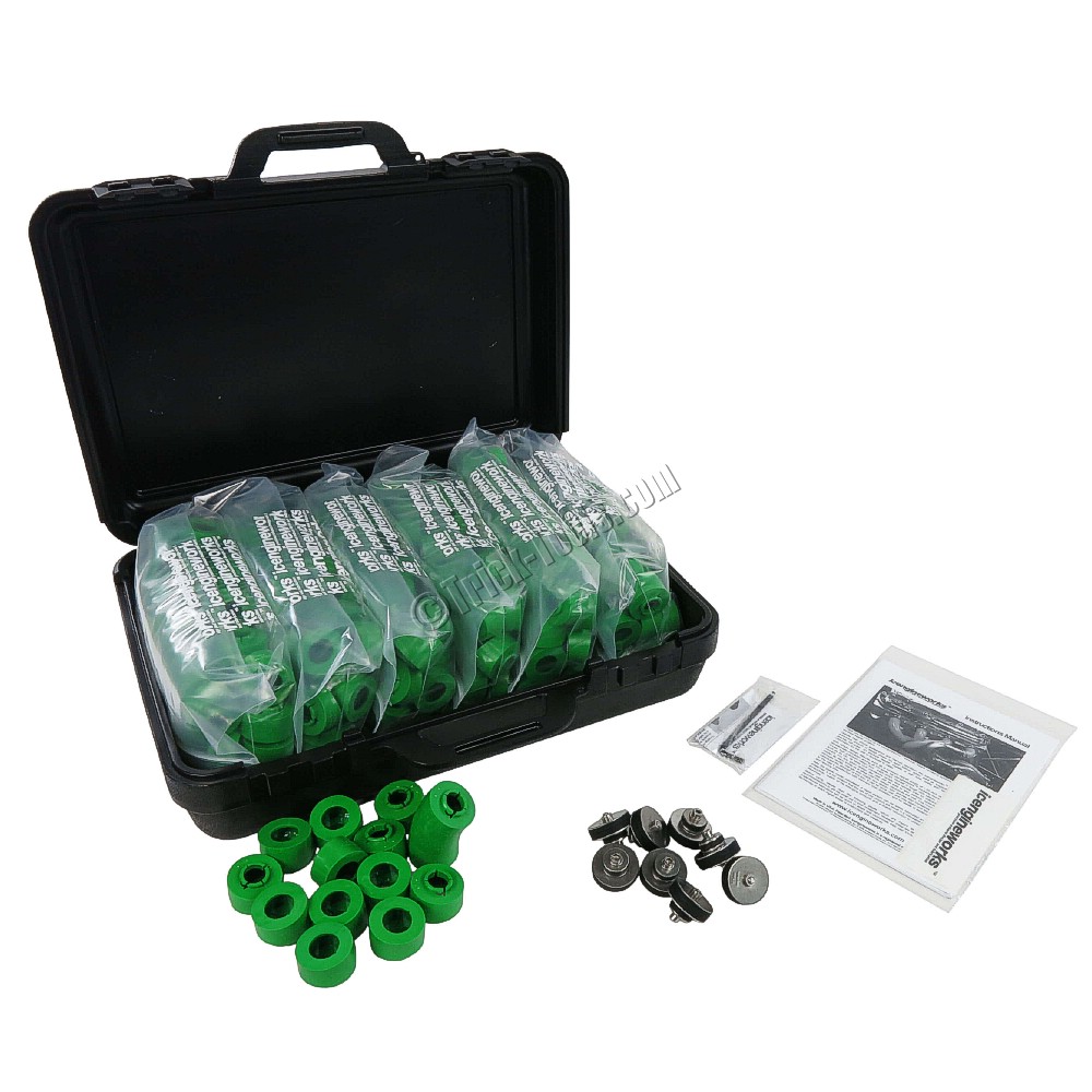

Posted 2019-09-03 2:14 PM (#586986 - in reply to #585308)
Subject: RE: Hemi Powered '56 Plymouth
Posts: 9539
50002000200050025
Are you using this? What clever person that was who came up with that.
https://www.trick-tools.com/Icengineworks-1-7-8-inch-Pro-Header-Mode...
Posted 2019-09-03 3:03 PM (#586989 - in reply to #480421)
Posts: 9430
50002000200010010010010025
Yes, but they are too expensive for what they are. I paid $650 for a glorified set of legos. I got the same set as shown in your link but found an older, cheaper price. Can you believe that the price actually went up on these??? Also, it's nice to have a large selection of bends, but if you are piecing it together from J-bends like most home people, there are usually only 1 or 2 radii available to purchase so all those others are just wasted money and garage space. But they have priced it so that buying them in individual packages doesn't save you any money. They do help a whole lot with the design phase of a header build though.
Edited by Powerflite 2019-09-03 7:36 PM
