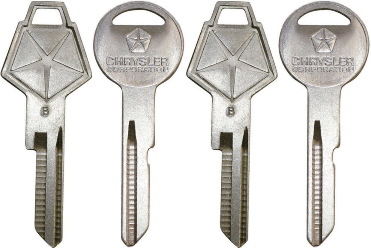

Can someone post a picture of the correct 57/58 keys that they have for their car.

The ignition/door key changed slightly starting in 1964 but most people/sellers don't recognize that fact because the key from 1967 will still work in the ignition of a '56 Plymouth. However, the problem lies at the door lock. The newer key has an extended ledge that prevents it from fully engaging in the older door lock. So if you see a blank that is advertised over that extended range, most likely it is made for the newer style door lock and not the older one. But many people are clueless, so it's possible that they list the same range for an older key blank.
Here is an example of the correct key for our cars.
https://www.ebay.com/itm/275215853662
https://www.ebay.com/itm/275215844887
This is a set of the keys with the forwardlook emblem. Notice that they list an extended range out to 1966. I believe they do this because the trunk lock changed in 1967, but I'm not sure. Confused yet?
https://www.ebay.com/itm/265334462059
(56-63 Mopar Key Blank 0.jpg)
Attachments 56-63 Mopar Key Blank 0.jpg (75KB - 161 downloads)

is this key blank the same for the door, ignition and glove box?

No, the glove box key is the same as the trunk key.

So the trunk key is a single grove and the ignition and doors are the double grove Correct?
So now which key is the original key blanks. The DPCD or the ilco Blanks.

No. The ignition and door key should be the same. The trunk is something else. Two different key
blanks. Imopar380 (Ian) is a professional lock smith. His opinion is not an opinion it is a fact.
You should pay attention to what he says.
Here is a set that would work for you. Note the Pentagon key is the ignition and door key. The round head
key is the trunk key. The blanks are NOT the same.
My 56 Dodge keys (that I had to get made from scratch) use an Ilco Y153 for the ignition and door key and a Y149 for
the trunk lock.
