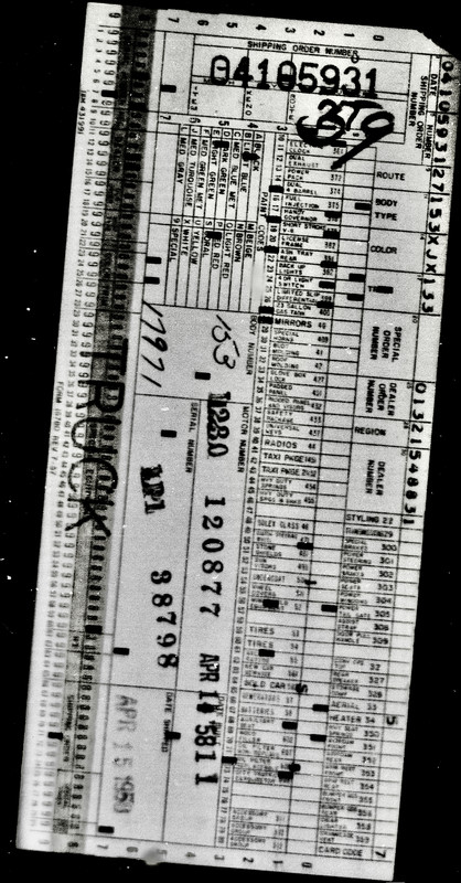

Hi all! Got my IBM card from Chrysler Historical, hoping that someone has a clearer card for comparison in some of the lower categories that can’t be read.

Hi, Chris - try a search o fthe Fender/VIN Tag and Broadcast Sheet Decoding section.  Type in "1958 Plymouth" and seach in titles, not threads.  Search all posts, not time range.  You'll come up with a bunch of threads to look at, and there are some good images of the punch cards.

Here what I could to recognize:
UPPER ROW:
BODY TYPE 153 – 6 Cylinder (1) Belvedere (5) 4-Door Sedan (3)
COLOR XJX – Iceberg White roof color (X), Arctic Turquoise body color (J), Iceberg White insert color (X)
TRIM 133 – White Vinyl Bolster and Black “Reflections” Pattern Metallic Threaded Jacquard Fabric Seat
271 – Styling
345 – Heater with Defroster
7 – Card Code (no idea what is it)
MIDDLE ROW:
501 – Undercoating
562 – Sold Car
608 – Replaceable Oil Filter
Your car has an manual transmission?

Yup! Originally had a three on the tree and a slant six until 2007ish when a PowerFlite Auto and a 318 were swapped in

Chris, your engine had 6 cylinders but it was definitely not a slant. It was a straight flat head. Slantsix was introduced in 1960.
