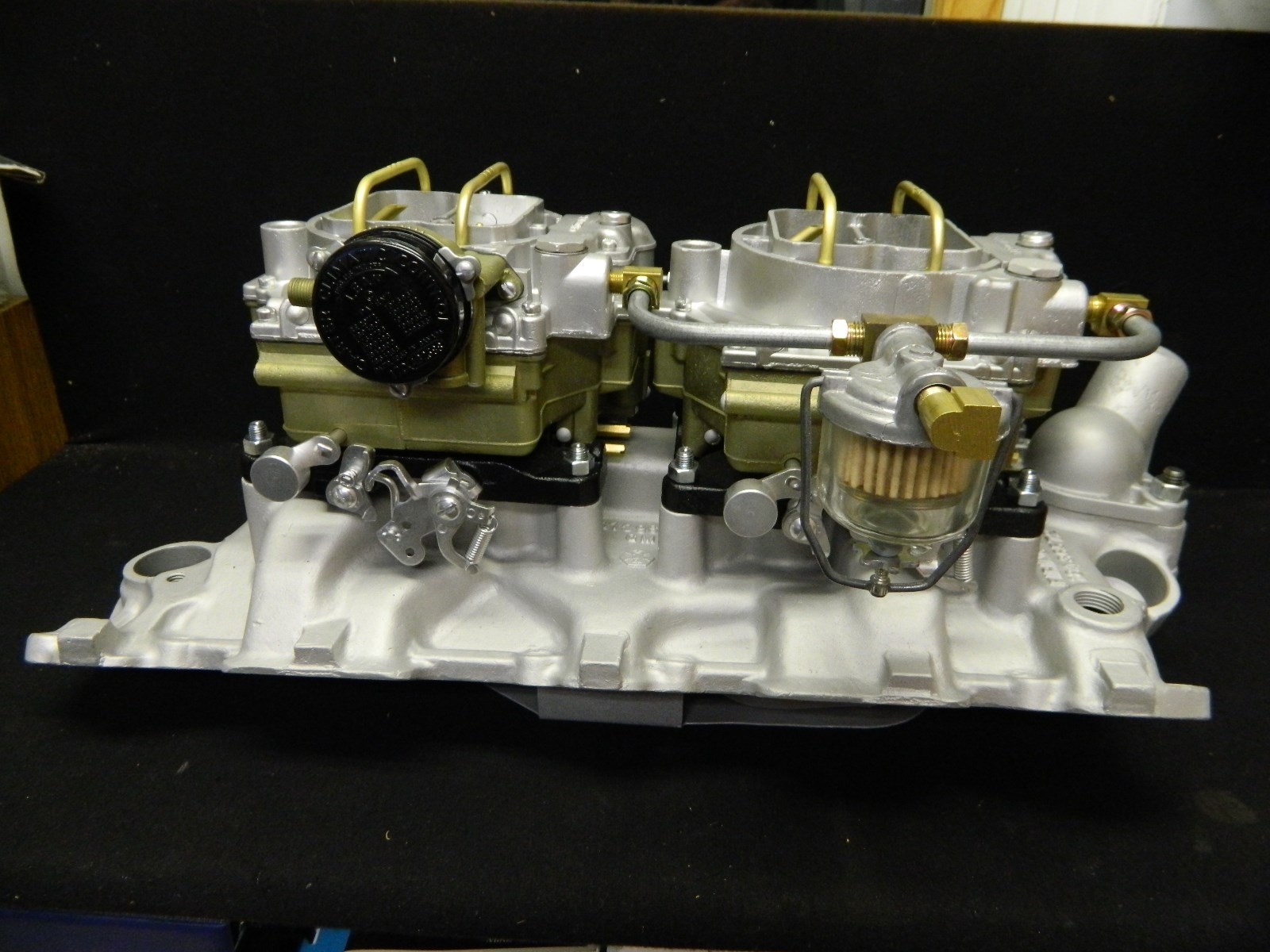

Agree. Probably very similar to this early Corvette dual WCFB quad set up:
