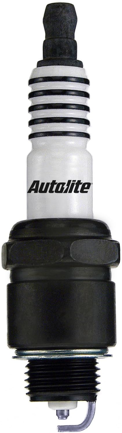

Del: On page 519 of the 56 Dodge FSM, it list the spark plug as a 14 mm AutoLite AR-52 plug. No mention of reach. I am not sure
where/why you have seen info that says the AR-52 is a 3/4" reach. It is not. Or at least it wasn't in 1956.
(NOTE: That said, the factory information sometimes screws up and gets confused so mention of a 3/4" reach might be possible)
However, this is the info that I have used in the past to guide me to the selection of plugs for my 56 315 double-rocker.
Discussion of reach for the 58 Dodge Engines:
One conversion chart (which translates an AR-52 to a AC Delco R45S or a Champion J-18Y (all 3/8" reach)
Apparently old AutoLite AR-52s now translate to AutoLite 86 plugs.
https://www.amazon.ca/Autolite-86-Copper-Resistor-Spark/dp/B000CIHNL...

Del: I hope that we can prevent you from making a mistake and installing 3/4" reach plugs in your 315 poly.

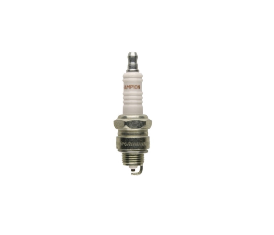

That old school NOS AR52 photo I posted above clearly shows that the plug has a 3/8" reach.
From the Conversion table that I posted above, the Autolite AR52 crosses to a Champion J18Y like this one:
https://www.ebay.ca/itm/255937375891
