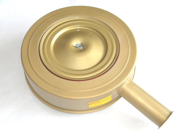

I am pursuing the 59-61 Golden Commando style air cleaner idea with the nice 3" diameter snorkel. Something like this one (but less pretty, and less expensive):
There would be 3" flexible ducting from the snorkel to the bulk head. Something like a piece of this flexible, expandable 3" aluminum ducting (8 ft for $9 at Home Depot):
Through the bulkhead/rad support, I envision cutting a 3" hole and inserting a 3" to 4" reducer. I was looking for a nice spun aluminum 3" to 4" reducer to fit at the rad support/ bulkhead. I find them on line but not in person (so far).

I "lucked" out and won an auction for a less than pretty 59-61 383/413 single snorkel air cleaner that should work with the through the rad support, behind the grill, air scoop option. The air cleaner was less than 1/5th of the very nice gold Golden Commando 383/413 air cleaner that I posted a photo of earlier. This one needs some work but that is fine. I need to paint it D500 hemi red (I have the official paint) anyway and I won't feel bad if I have to bash the bottom a bit to get the clearances for the fuel filter and the carb choke.
The pretty $299 one that was too nice and too much money:
https://musclecaraircleaners.com/products/1959-61-chrysler-golden-li...
The one I bought today:
https://www.ebay.ca/itm/292477495997?ul_noapp=true&autorefresh=true

Inspired (?!) by that stock Sweptside fibreglass air scoop and after watching some videos about making a fiberglass scoop over a sculpted foam core, I have bought some supplies to make such a scoop. This afternoon, I found yet another empty Raisin Bran box to cut up to create a rough mock-up of scoop that would sit behind the right grill bar and lead to a 3" hole in the rad support which would then lead on to the snorkel on 59 Chrysler 383/413 air cleaner (which arrived today at my US mail drop - pick it up tomorrow). There will be conflicts: I would like the scoop to be bigger than the Raisin Bran box and that would mean that the right horn will have to go or otherwise be turned or (???).
Here's a peak at the current concept:

As shown, you are going to lose most of the benefit from the air drag inside that hose. Is there any way to increase it's diameter dramatically? In general, you want to keep the inside area the same as the inside area that you start with, except that it can decrease a little as the drag slows it down. The slow decrease of area will keep the speed up so you won't lose your dynamic pressure differential. You will lose a lot of air speed once it hits the air filter, but you want to keep the speed up until it reaches that point at least.

Thanks for the comments Nathan.
I haven't got the aircleaner in my hands yet. I will be going to Point Roberts WA tomorrow to pick it up. I am told that the diameter of the snorkel is 3":
I could go 4" diameter on the scoop outlet and through the rad support and then use 4" flex hose. But at the end, I have to go down to 3" unless there is enough height on the side of the aircleaner to cut off the 3" snorkel and get a 4" welded on.
Alternatively, I could go 3" I.D. hard pipe from a 3" scoop outlet @ the rad support and then over to the air cleaner with only a bit of 3" flex at the end.
Picked up the eBay $55 Golden Lion air cleaner today. It's going to work. I am going to have to beat it a bit with a ball peen hammer to get some clearances for the choke, carb fuel line and the PS pump but I was expecting that. At least I didn't buy the $299 gold air cleaner, that would have hurt to hit with a hammer. This one, no problemo.
The snorkel isn't 3". It is just 2.5" so I am likely going to have to make the inlet snorkel bigger. The side of the can is just over 3.5" so 4" is out but something a bit bigger than 3" might work. I suppose ovalish rectangular is possible too with a modification of the internal baffle that chases the incoming air around the inside of the can.
The WIX 42041 that I picked up yesterday fits perfectly. Quality piece. Made in Poland, not China.

Attachments eBayGoldenLionAirCleanerOn56D5004bblHemi_SnorkelToScoopPathway_Annotated.jpg (220KB - 952 downloads)
Attachments eBayGoldenLionAirCleanerOn56D5004bblHemi_SnorkelInsideDiameter2point5inches.jpg (71KB - 947 downloads)
Attachments eBayGoldenLionAirCleanerOn56D5004bblHemi_Snorkel_BaffleAtInnerEnd.jpg (73KB - 921 downloads)
Attachments eBayGoldenLionAirCleanerOn56D5004bblHemi_CanSideHeight3point5Inches.jpg (91KB - 928 downloads)
Attachments eBayGoldenLionAirCleanerOn56D5004bblHemi_InterferencesWithChokeAndFuelLine.jpg (115KB - 901 downloads)
Attachments eBayGoldenLionAirCleanerOn56D5004bblHemi_InterferenceWithPSPump.jpg (115KB - 918 downloads)
Attachments eBayGoldenLionAirCleanerOn56D5004bblHemi_InterferenceWithPSPump_1.jpg (115KB - 918 downloads)
Posted 2018-03-24 5:32 PM (#560425 - in reply to #560416)
Subject: Re: Pre-FL Functional air scoop
Posts: 10992
50005000500100100100100252525
Well Dave, I see you have a clearance problem, Dave
Why yes HAL, I do have a clearance problem, HAL.
Well Dave, have you considered making a spacer instead of using a ball peen hammer, to solve your problem, Dave?
Well, no HAL, I had not. What do you suggest HAL?
Well Dave, have you had a look at the McNichols pipe sizing chart, Dave?
Well, not HAL, I have not. Do you mean this one, HAL? http://www.mcnichols.com/?pageCode=pipedims
Yes Dave, that is the one. Perhaps you could consider a Schedule 10 Nominal 4 inch pipe. It has a 4.5" outside diameter and a 4.26" inside diameter. I believe you will find that the 4.26" ID will sit on the carburetor nicely Dave and the air cleaner will sit on the 4.5" OD nicely as well, Dave.
Well, HAL thank you very much for that. Now, could you please open the Pod bay door. I really, *really*, need to pee.
I'm sorry Dave, I'm afraid I can't do that. This conversation can serve no purpose anymore. Good bye Dave.

Had a few minutes before we went out for Sunday brunch so I found the ABS pipe bit that I have been saving for a rainy day. Didn't measure anything, just cut (very crudely ) what I thought would be needed and trialed it. It was Schedule 40 so the wall thickness is a bit much and would need some trimming at the carb. Might need something else at the top, where the air cleaner sits on it. Nevertheless, it does show that a spacer is probably doable and the way to go.
I do have 4 more feet of pipe to cut a nice 1.25" ring if I decide to stick with Schedule 40 (and not Schedule 10 as I thought would work better).
The proof of concept photos:
Edited by 56D500boy 2018-03-25 5:03 PM
(CrudelyCutSchedule40ABSSpacer_1.jpg)
(CrudelyCutSchedule40ABSSpacer_2.jpg)
(eBayGoldenLionAirCleanerSittingOnTrialSchedule40ABSSpacer.jpg)
(CrudelyCutSchedule40ABSSpacerWithEbayGoldenLionAirCleanerShowingClearanceGained.jpg)
Attachments CrudelyCutSchedule40ABSSpacer_1.jpg (122KB - 860 downloads)
Attachments CrudelyCutSchedule40ABSSpacer_2.jpg (148KB - 863 downloads)
Attachments eBayGoldenLionAirCleanerSittingOnTrialSchedule40ABSSpacer.jpg (158KB - 883 downloads)
Attachments CrudelyCutSchedule40ABSSpacerWithEbayGoldenLionAirCleanerShowingClearanceGained.jpg (108KB - 878 downloads)

Thanks for the comments. I like the way you guys think.
I don't have any welding or CNC skills (wish I did). What I do have is the type of mind that can see re-purposing something, like a cooking pan, if the size was right. I didn't see either of your two posts guys before I went out to the local Medium-Box Hardware store, "RONA", was the Canadian version of Lowes/Home Depot (now owned by Lowes but still called RONA). I actually went to buy some styrofoam bead board to laminate and to start sculpting the shape of the air scoop. However, I also wandered into the plumbing section where I bought a 4" x 3" (both nominal) ABS black plastic reducing coupling and a 4" x 4" thin-wall PVC coupling. The 4" end of the reducing coupling fits over the 4" nominal Schedule 40 black plastic plumbing pipe *AND* the 4" nominal PVC coupling. The ABS reducer was $7.89 and the PVC coupling was $2.49. The "Transition" glue to bond the ABS and PVC was $4.99. So not much money into it.
Got those all home and started to work.
First thing was to test the 4" x 4" PVC coupling on the carb. Must be Schedule 10 because it fit perfectly over the carb. Nothing to trim out there (except height).
Then I tried the 4" x 3" reducer on the bottom flange/nipple of the Golden Lion aircleaner at the 4" nominal end. A bit tight. Needs some grinding/sanding to fit better. No biggy.
Then I cut the 4" x 3" reducer at the 4" nominal end to create a collar to corral the 4" nominal PVC coupling. Cut it about 3/4" high on my table saw (cutting ABS stinks BTW).
Sanded off the burrs from sawing and pushed the new collar on to the bottom of the air cleaner. Then I inserted the white PVC coupling into the collar. Fit beautifully.
Then, without cutting the white PVC coupling but leaving it in the ABS collar that was pushed onto the air cleaner, I tried the assembly on the carburetor. Definitely got clearance now (LOL). Tomorrow, I will figure out what the real height I need is and then cut the coupling. I have two halves to get it right. Even if I screw both of them up, the coupling was only $2.49 and I can get another one and try again.
I might incorporate the remaining bit of the 4" x 3" reducing coupling into the air scoop because the OD of the 3" nominal end is pretty much 4" and 4" flex hose would fit over it. Just need to make the snorkel on the air cleaner appropriately larger.
Edited by 56D500boy 2018-03-25 9:00 PM

Since probably before I even bought the green eBay Golden Lion air cleaner shell, I knew that the snorkel was going to be too small for my plan(s). So the other day I bought a couple of pieces of 3.5" OD Pipe that I could work with. The first one had an 1/8" wall thickness - likely too thick. Then I went to my friendly local muffler shop and got a piece of 14 gauge 3.5" exhaust pipe. (Cost me $8).
When I got home I show these to my metal fabricator-by-trade neighbour and he suggested using the exhaust pipe and scribing it to the metal can. That was the other day.
I had some time while some primer was drying on the car (behind the right grill bar), so I started the removal of the old snorkel.
This is what I started with:
I used my Dremel with a cut-off wheel to cut off a section of crimped joint between the upper and lower halves of the air cleaner shell. That allowed me to get the exhaust pipe closer to the shell and make the initial scribes. I thought I would be using the Dremel to cut the hole but it was too awkward on the small radius. SO I used my hacksaw to remove as much of the snorkel as possible. That allowed me to use my Bosch jig saw (with metal blade) to cut the initial scribed hole (staying on the inside as much as possible).
With that material out, I rescribed the hole to the exhaust pipe and started using my angle grinder and plug stone to grind away the unwanted material. Many tries and re-scribing. Slowly slowly and oops the exhaust pipe slipped into the hole. I am quite pleased with the fit.
Now I need to get it tacked in place and welded to the shell. Might be a bit tricky. Will cost me a case of beer.
Today's fun:
