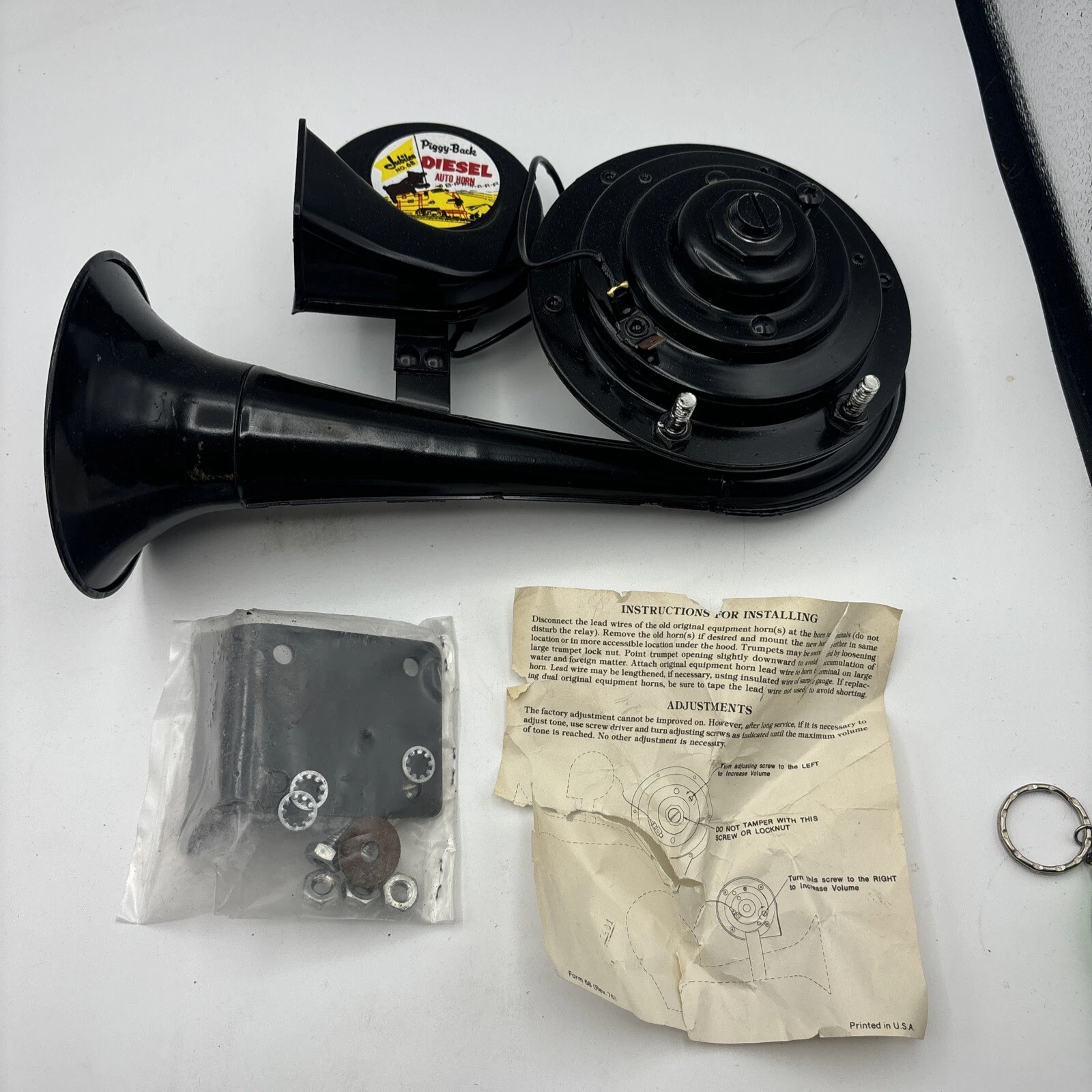

This one might work for you:
https://www.ebay.com/itm/305724872585?
Mine:
Edited by 56D500boy 2024-09-09 2:42 PM
